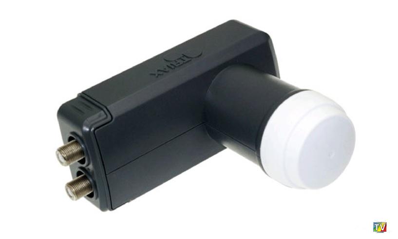

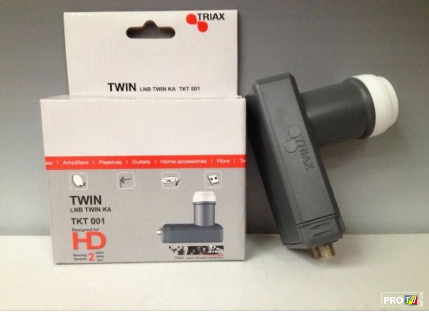

Triax Twin KA Band Saorsat LNB
Outputs: 2
Color: Grey
Neck diameter: 40mm
Frequency Range: 19.7 - 20.2 GHz
L.O. Frequency : 21.2 GHz
Noise Figure: 0.1dB
Output Connector Type: F-Female
Full HD 1080P
HD DVB-S2 Compliant
Circular Dual Polarity

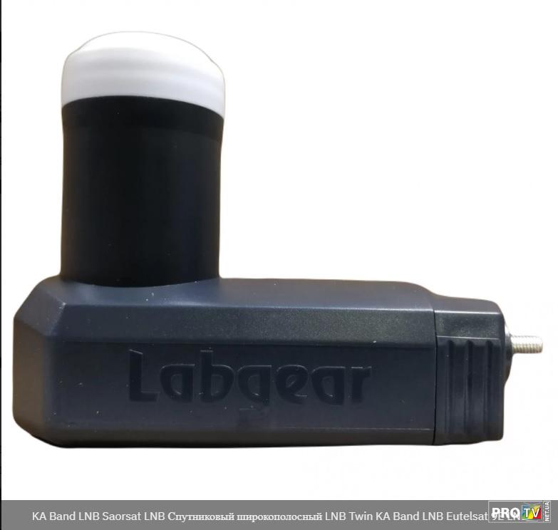

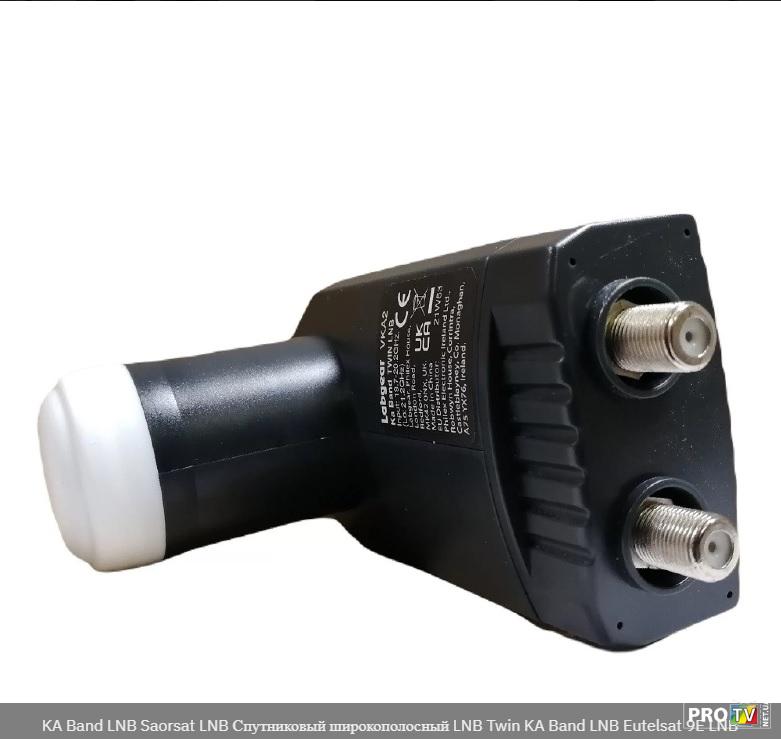

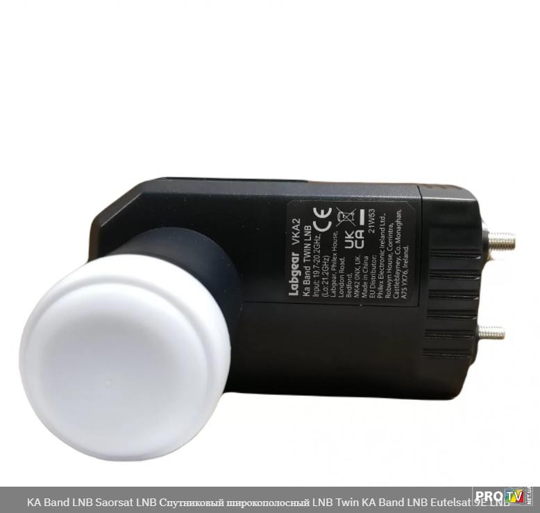

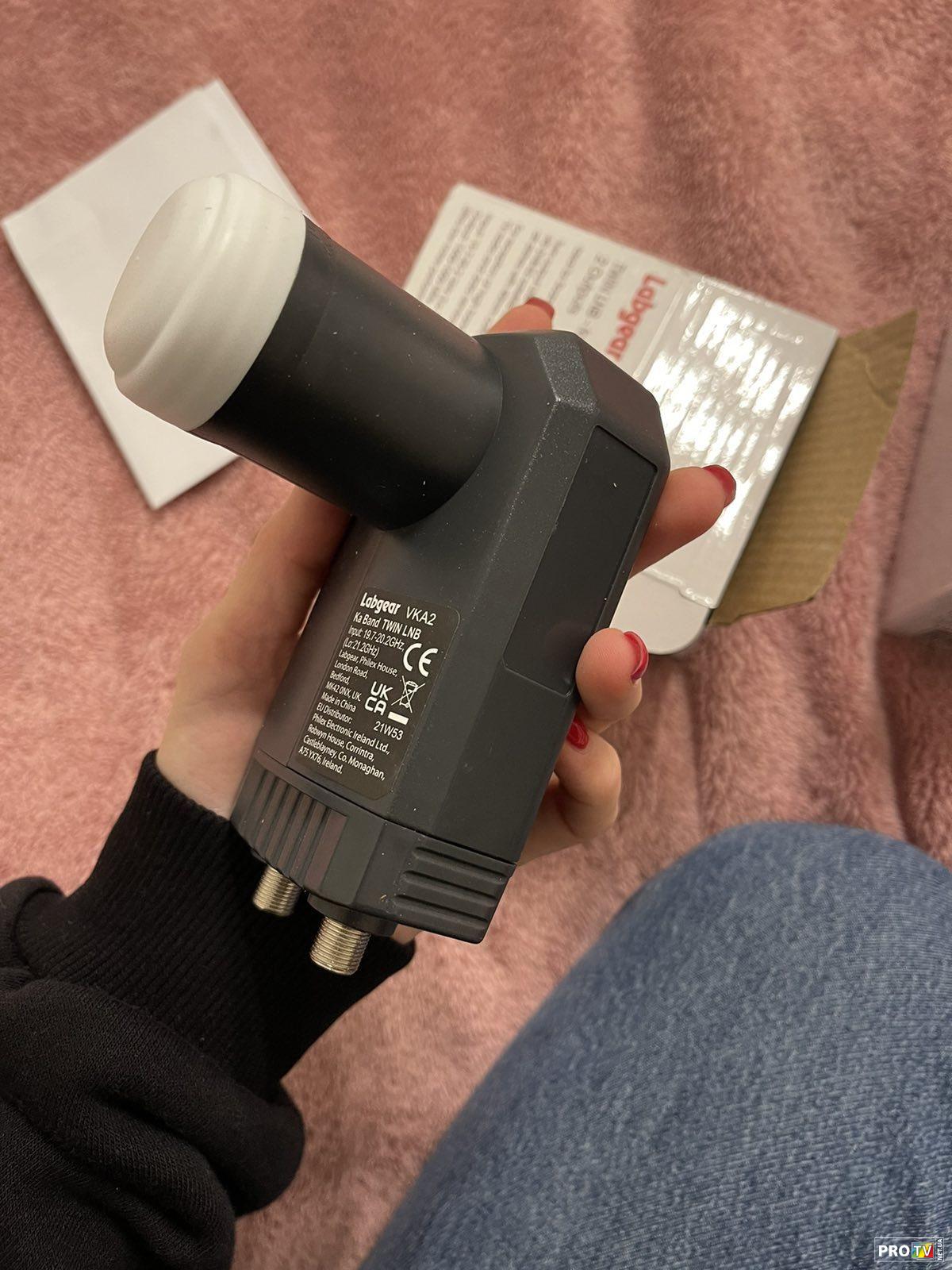

Заказали Мы в Ирландии вот такой КА конвертер 19.7GHz ~ 20.2GHz.
Labgear Saorsat KA-Band LNB
DESCRIPTION of Saorsat KA-Band LNB
Saorsat KA-Band LNB
Manufacturer: Labgear
Input frequency range: 19.7GHz ~ 20.2GHz
Output frequency range: 1500MHz ~ 1000MHz (spectrum inversion)
Low band LO frequency: 21.20GHz
LO temperature drift: ±3.0MHz Max.
LO initial accuracy: ±1.0 MHz Max.
Polarization: Dual circular for Ka band (RHCP/LHCP)
LO phase noise @ 10kHz: -85dBc / Hz max.
LO phase noise @ 100kHz: -100dBc / Hz max.
Conversion gain: 50dB ~ 65dB
Gain ripple (over 26MHz bandwidth): ±0.75dB
Gain variation (over full band): ±5dB max.
Image rejection: 40dB min.
1dB compression point (@ output): 0.0dBm min.
Cross polarization isolation: 22dB tpy
Polarization selection - LHCP: 13V
Polarization selection - RHCP: 18V
Output VSWR: 2.0 : 1
In band spurious level: -60 dBm max.
Current consumption: 170 mA max. @ 11 V ~ 20 V
Operating temperature: -30°C to +60°C
Output impedance: 75Ω
Fits all universal satellite dishes with a 40mm LNB holder
