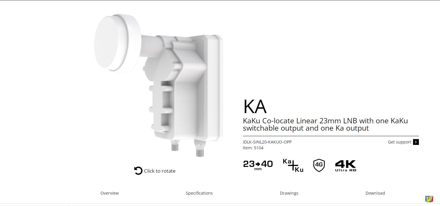

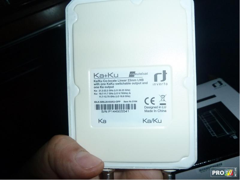

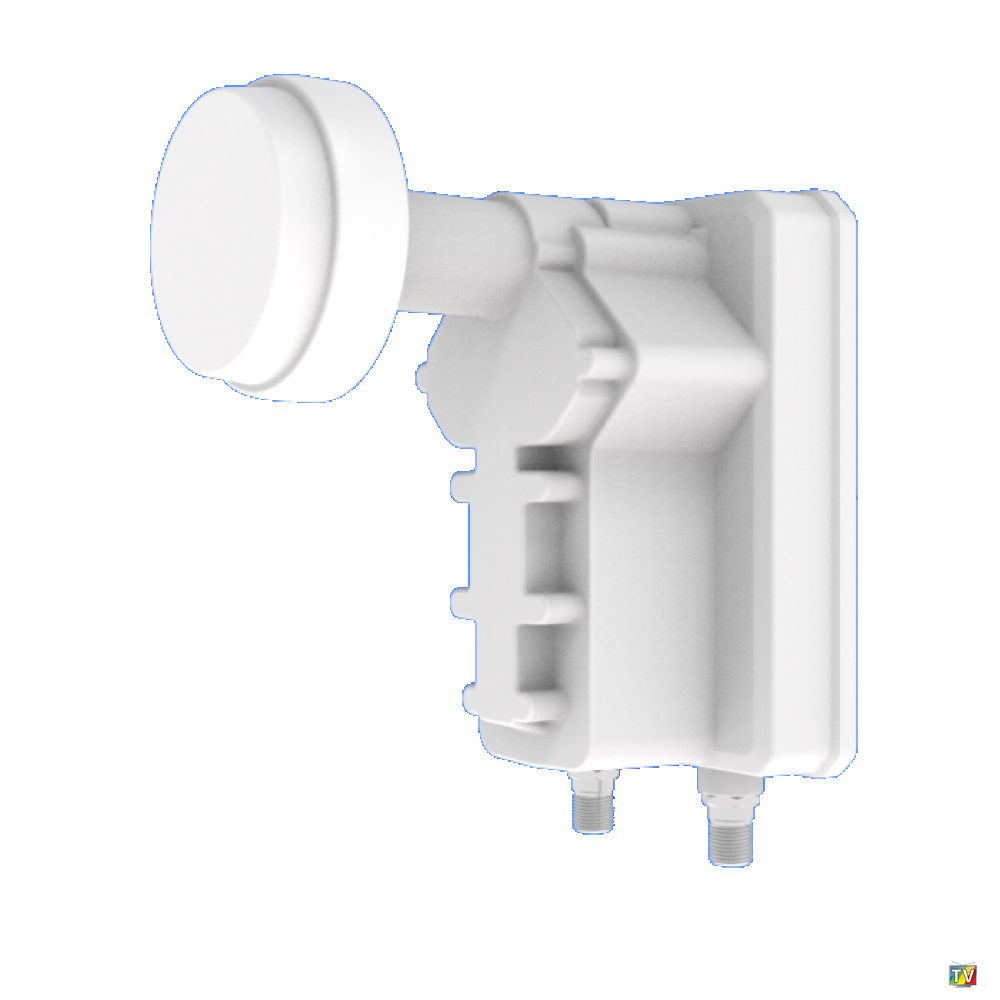

Комбо модель:
Technical specifications: Inverto IDLK-SINL20-KAKU-OPP
Ku band range: 10.7-12.75 GHz
Ka band range: 21.2-22.2 GHz
Polarity and switching: Linear, V/H switchable by 14/18 Volts
LNB outputs:
Output 1: Ka/Ku
Output 2: Ka band Ka/Ku band
Switching on Output 1: DiseqC 1.0 A/B, Port A: Ku band, Port B: Ka band
Used technology: Dielectric Resonator Oscillator (DRO) and Ultra Low Noise Technology

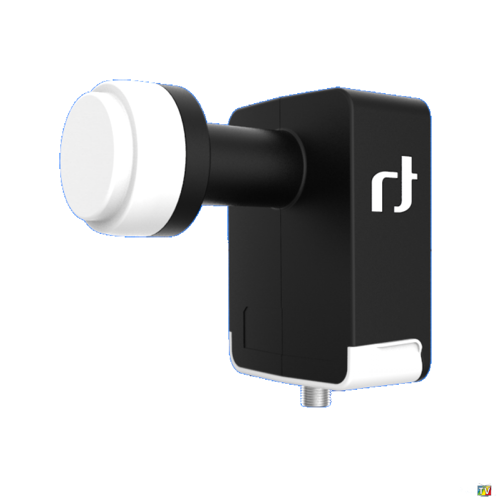

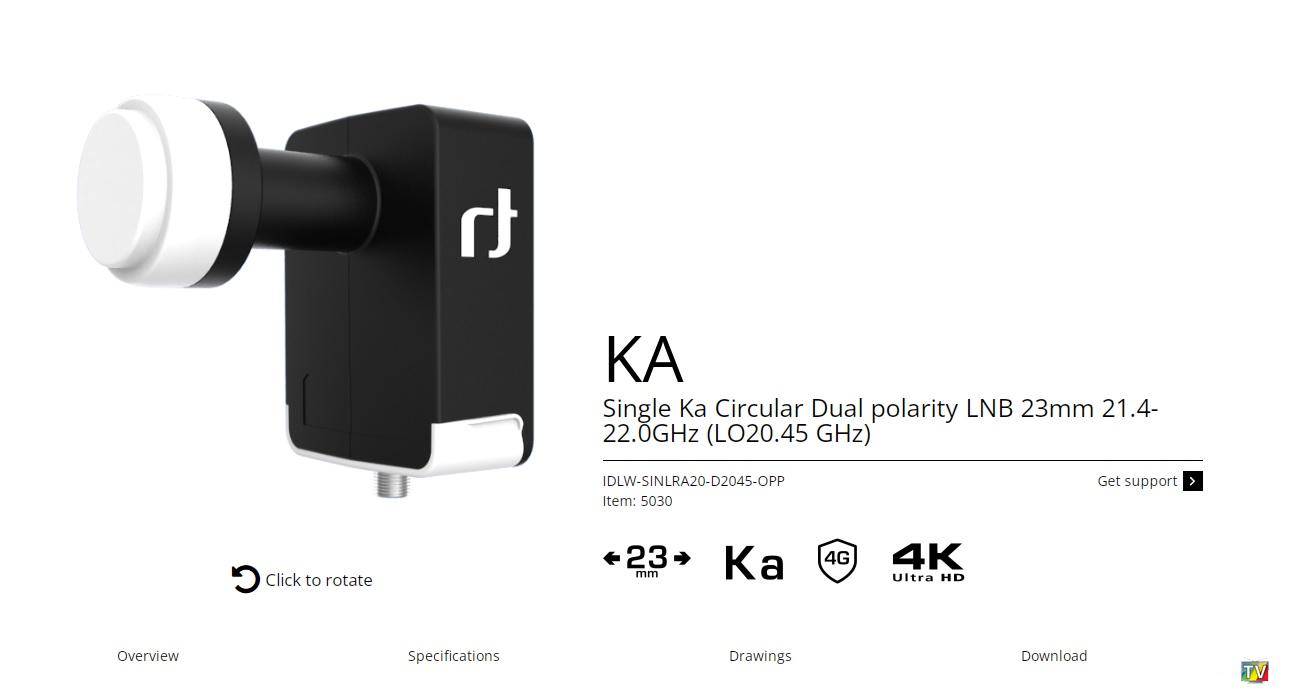

 Заголовок сообщения: Re: Конвертер KA Band (21,4 to 22,0 GHz) sub-band D
Сообщение Добавлено: 12 янв 2023, 21:01
Single KA Circular DUAL Polarity LNB 23 mm
IDLW-SINLRA20-D2045-OPP
nput frequency range 21.4 GHz - 22 GHz
Input frequency range 21.4 GHz - 22 GHz
Output frequency range
950 MHz ~ 1550 MHz
Noise figure
1.3 dB typ.
LO frequency
20.45 GHz
LO temperature drift ±5.0 MHz max.
LO initial accuracy ±1.0 MHz max.
Polarization
Dual circular for Ka band (RHCP / LHCP)
LO phase noise @ 10 kHz
-75 dBc/Hz max.
LO phase noise @ 100 kHz -95 dBc/Hz max.
Conversion gain
50 dB - 60 dB
Gain ripple (over 26 MHz bandwidth) ±0.75 dB
Gain variation (over full band) 5 dB max.
Image rejection
40 dB min.
1 dB compression point (@ output) 0.0 dBm min.
Cross polarization isolation 22 dB min.
Polarization selection - LHCP 13V
Polarization selection - RHCP 18V
Output VSWR
2.5 : 1
In band spurious level -30 dBc Max.
Current consumption
120 mA Max. @ 11 V ~ 20 V
Operating temperature
-30 °C ~ +60 °C
Output impedance
75 Ω
Output connector type
1 x F-Type (female)
Weight 90 g
